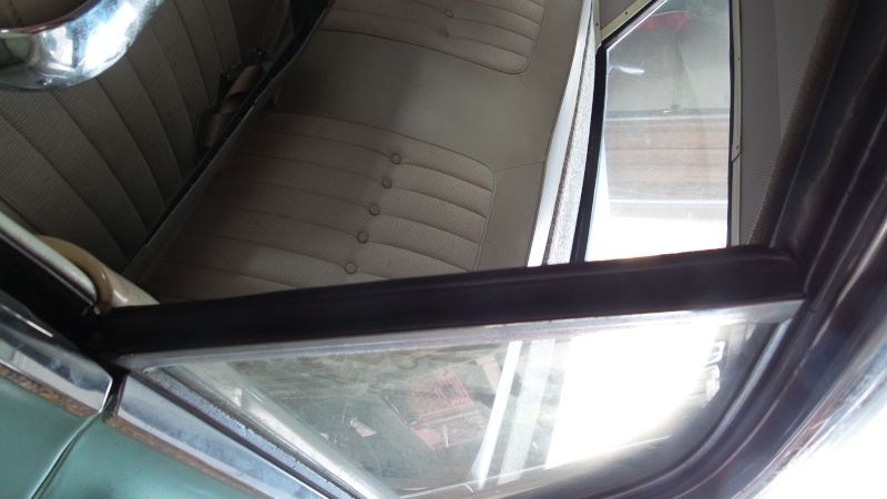

This is the only pic I have available at work that shows it but I think that could be one of the minor differences between a 61 and a 62 -- mine doesn't have a roof rail seal that Im aware of.  It has a post between the front and rear glass.  Mine doesn't have a separate rear division post seal it was all one pc -- here's a pic of what I pulled out too. This went all the way up one side, across the top, and then back down the other on the qtr window.

Post by Esasky's62Lark Mon Mar 21, 2016 12:14 pm
I gotcha.
your car is a post car. Mine isn't. I actually have a roof rail seal that goes from the wing window (A pillar) all the way to the quarter window in one continuous seal.
Both front and rear glass seals to that and I have that rear division post seal that seals between rear of door glass and quarter glass.

Did that piece actually go on the glass...? If so, then yes, I have that window frame as well. that seals to the roof rail seal.

Post by regal81455 Mon Mar 21, 2016 1:18 pm
Esasky's62Lark wrote:Did that piece actually go on the glass...?  If so, then yes, I have that window frame as well.  that seals to the roof rail seal.
No, this is sandwiched in between the outer chrome mouldings and the inner window trims and yes mine is a post car -- I do not have roof rail seal -- my door is sealed with one large door seal that goes all the way around it. I'll take better pics tonight so you can see exactly what Im working with.

Post by Esasky's62Lark Mon Mar 21, 2016 1:51 pm
I gotcha. Just had to understand where you were coming from. I have never seen the post version of our cars. :-)
