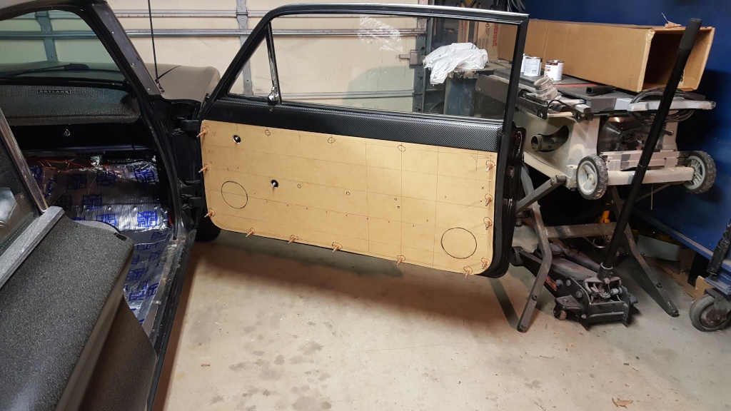

Used old door card as template -- trimmed a little for fitment and mocked up passenger side.  Once I was comfortable with layout etc... a little time spent with the flush trim bit on the router table and BAM both door cards done and ready for covering!! What a Face What a Face What a Face
