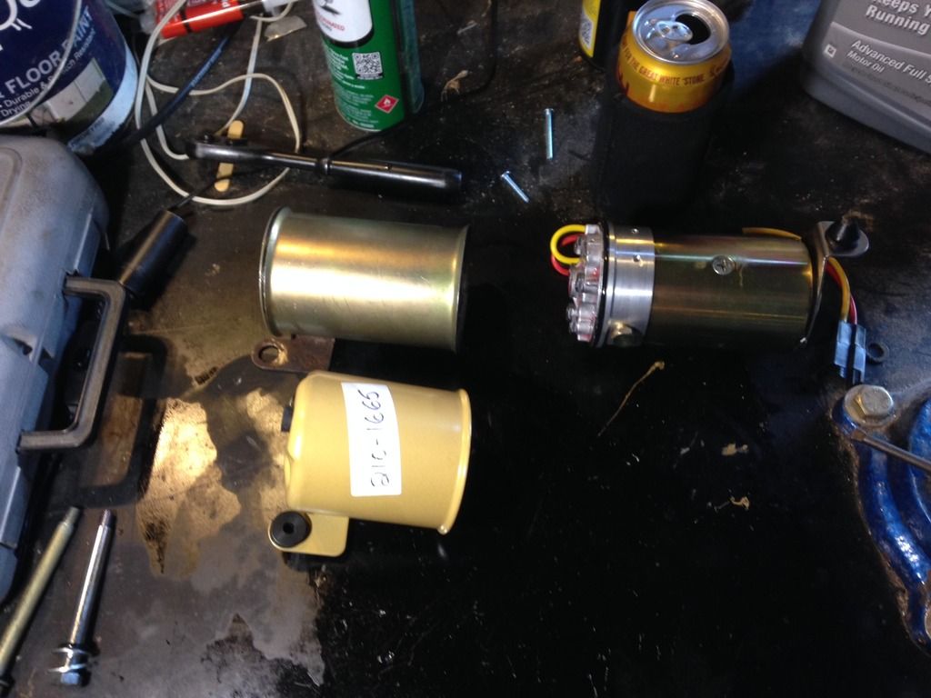

Here's the inside of the motor with the two bolts removed :
I was still optimistic that I could fix it. So if you're interested just drill out these solders:
And you have pull out this rotor. It has a ball that's spring loaded into the case. It took a few well placed blows to a vice grip attached to the rotor.
At that point I was able to start trying to remove the field coils in the pump part of the motor. That junk was so caked in that I had to use heat to swell the case enough to get movement, but that caused the plates of the field coil to separate... I decided to cut bait... I've ordered a new pump and hose kit for the top and I'll be purging the hydraulic cylinders and converting to ATF. I could have messed with rewinding the field coil, but I still would have needed new brushes and the wiring was pretty crusty etc. If someone needs a motor or pump case let me know. I'll be hording these for a while.

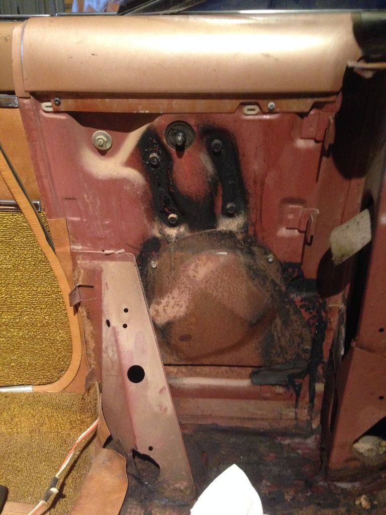

I planned to redo the brake system, so having the motor out of the way will be nice. I'll probably converting the front to disk. Seems cheap and easy. I need all new parts including a master cylinder. Basically anything that could have melted under the hood did. Including the lead in the battery!

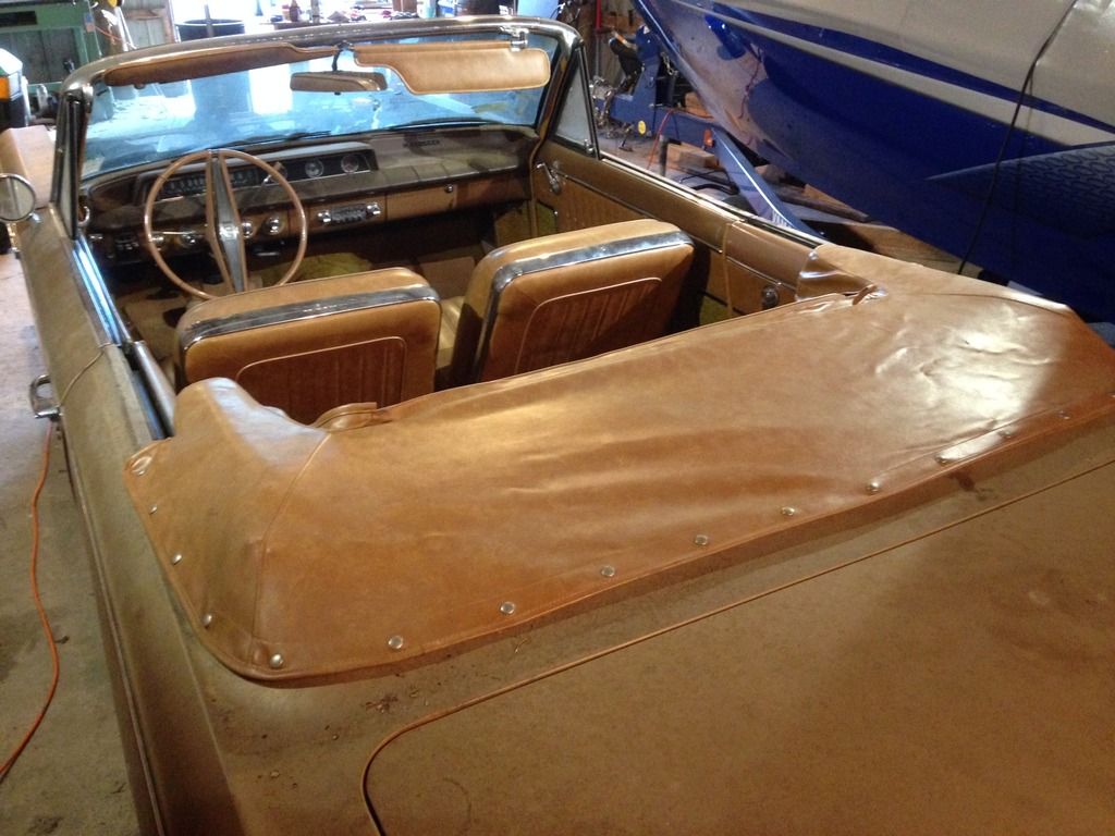

Got the top dropped yesterday. It was nice to stand up in the car to do work.

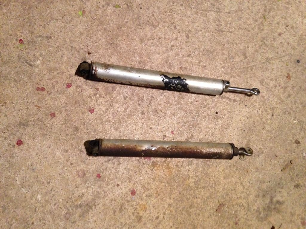

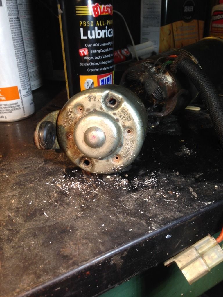

So I decided to keep working on the mechanical part of the top. Ordered a new pump and lines. I removed the old cylinders to get all the brake fluid out and to clean them up to help w/ leak spotting.
Next up was the pump. The one I ordered was supposed to fit a 63 skylark, but it didn't fit mine. It could be some wierdness with the mounting brackets, but I was able to swap the reservoir part and it all worked out. Below you can see the differences in the length of the reservoir.
Last night I bled the system. I needed to replace the rubber bushings on the lower pivot of one of the cylinders and found these (below) from O'Reilly's. I'll be able to confirm they work in a few days.

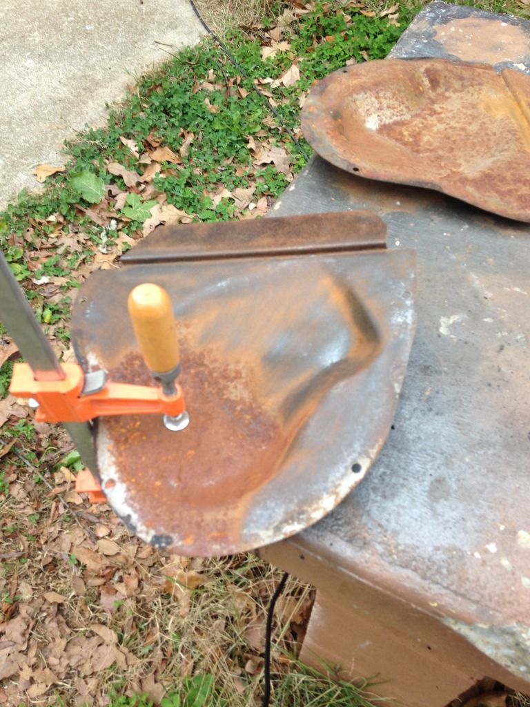

I made this access panel pretty again

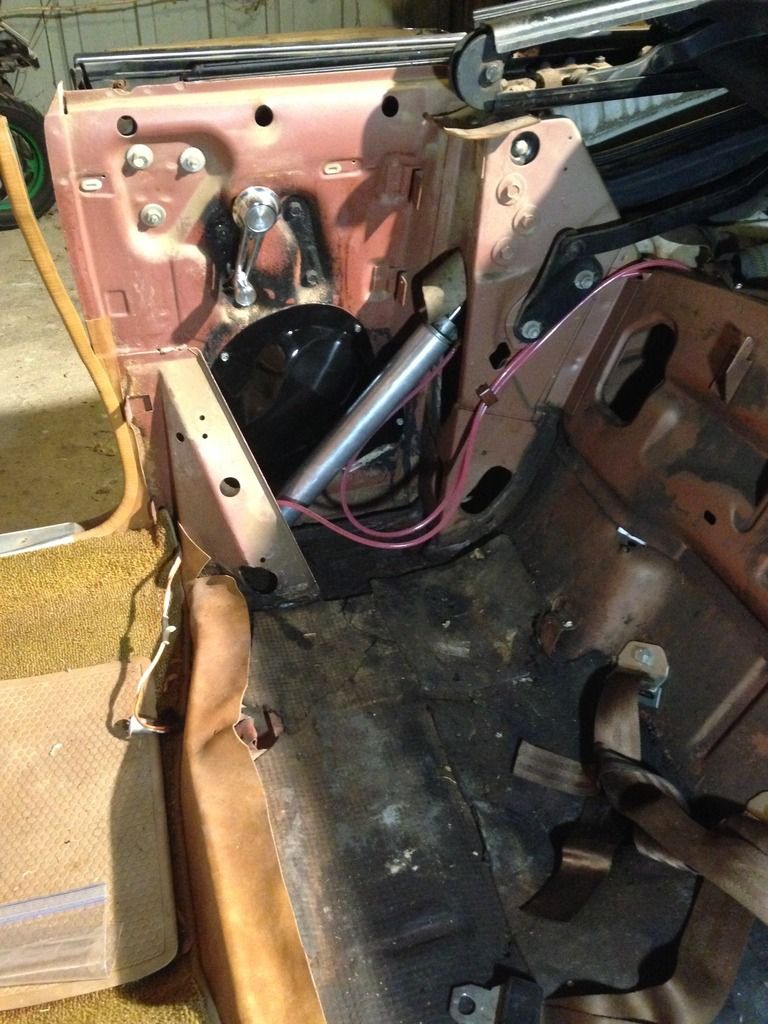

Installed with the cleaned up cylinders and new hose, pump, and ATF.
The grommets I got from O'Reilly worked pretty well.
Top drops and all is right in the universe.
