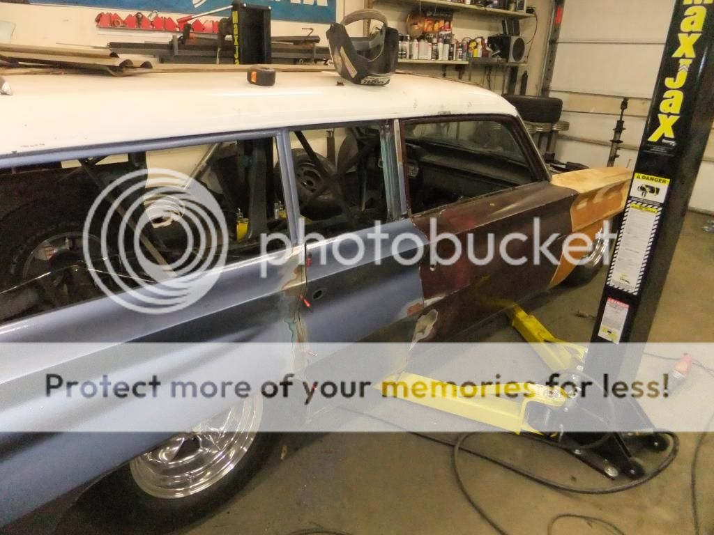

Ok this is just a test to see if I can upload a picture. This is the beginning of a conversion to a two door from a four door. 62 Buick Wagon Two Door Usermedia.php?uo=nvlS1L5AwLPB1nLOvnD%2FC4h4l5k2TGxc#

62 Buick Wagon Two Door DSCF0407_zps10b1fad1_1
Ok now I have it. This is first pic showing the car with a two door sedan door along side of the car and how much longer it is than the front four door door

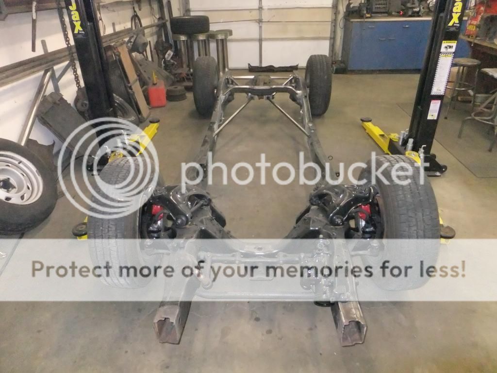

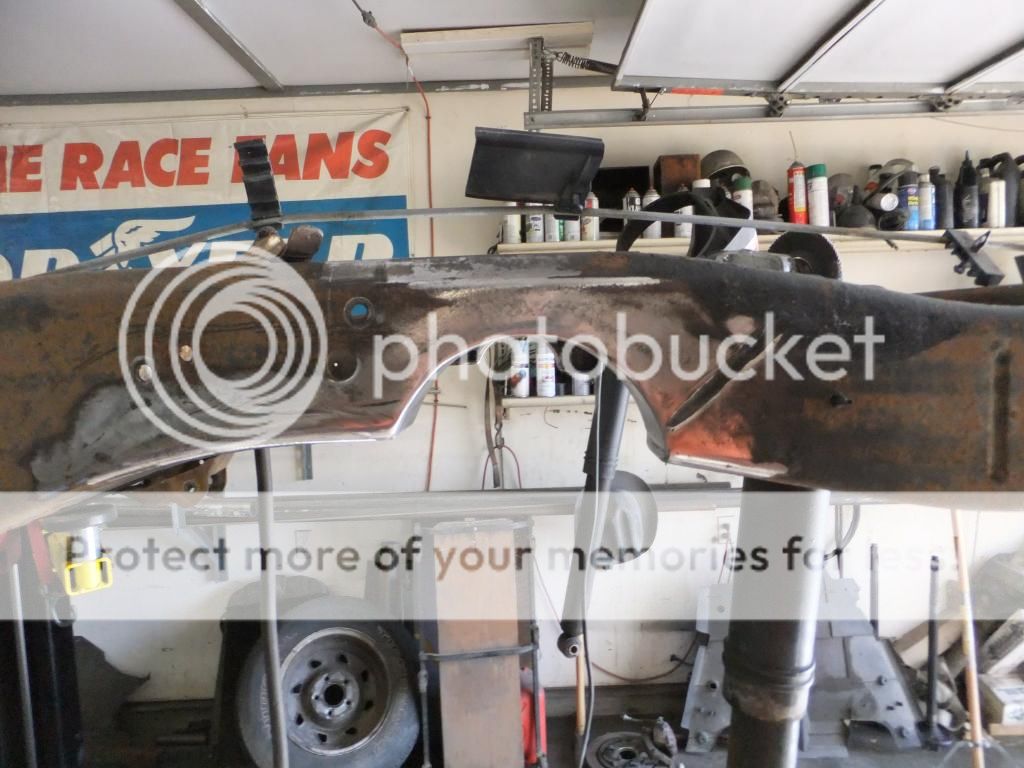

62 Buick Wagon Two Door DSCF0401_zpsc694ddda
S10 frame being used. Stock before adding 4" to wheelbase for wagons 112" wwb

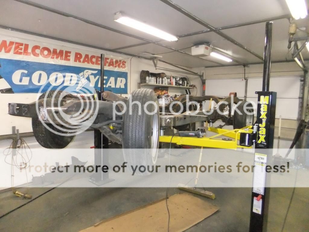

62 Buick Wagon Two Door DSCF0414_zps5f5270fa
62 Buick Wagon Two Door DSCF0428_zps21a01669
62 Buick Wagon Two Door DSCF0442_zpsa1f095b4
62 Buick Wagon Two Door DSCF0456_zpsf5d32b1c
62 Buick Wagon Two Door DSCF0470_zps297b56ee
62 Buick Wagon Two Door DSCF0480_zps3be80d1b

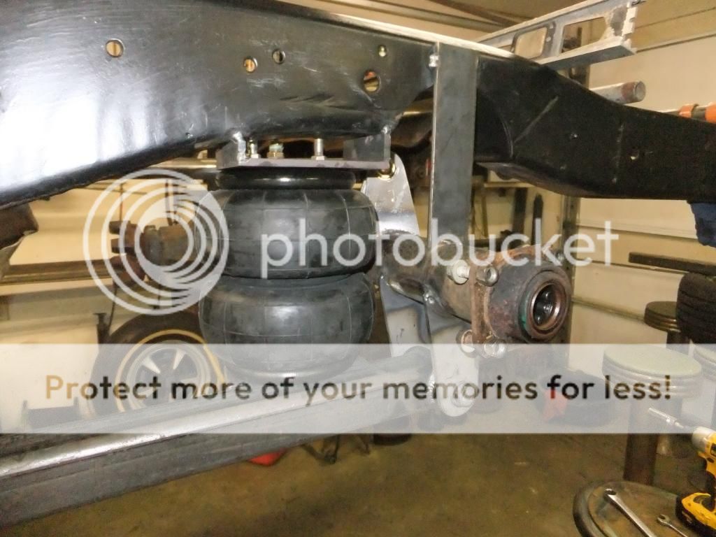

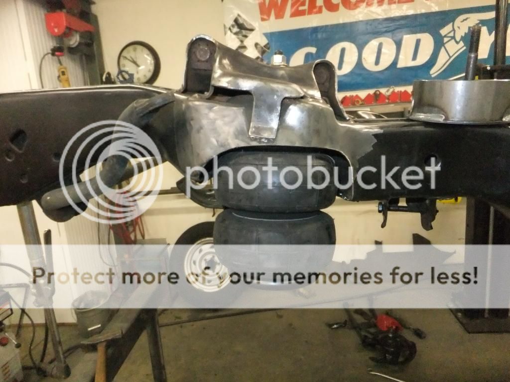

These are pics of frame modifications for air ride with four link rear and initial fit of body

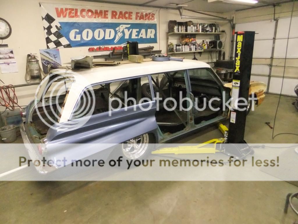

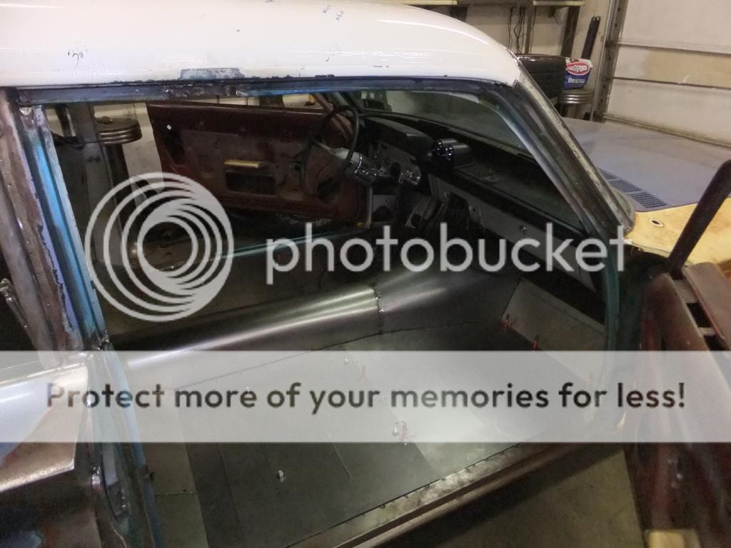

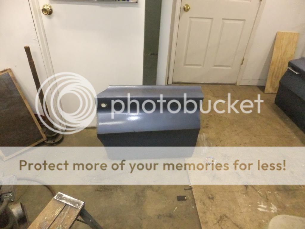

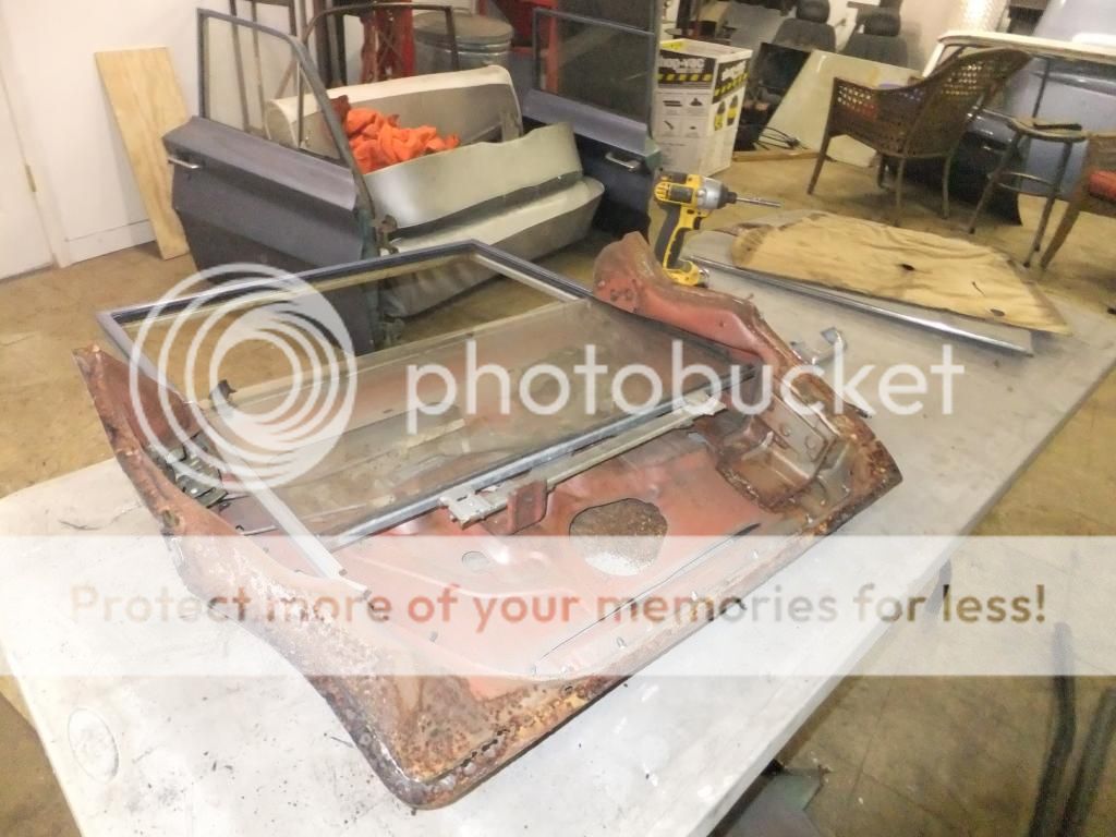

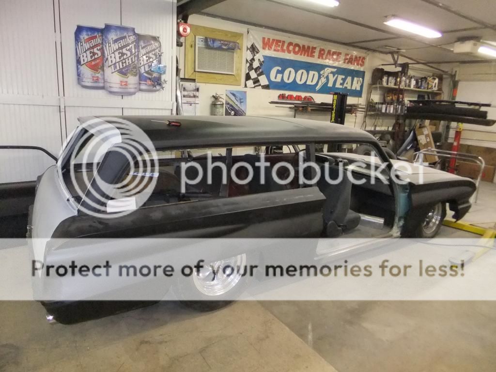

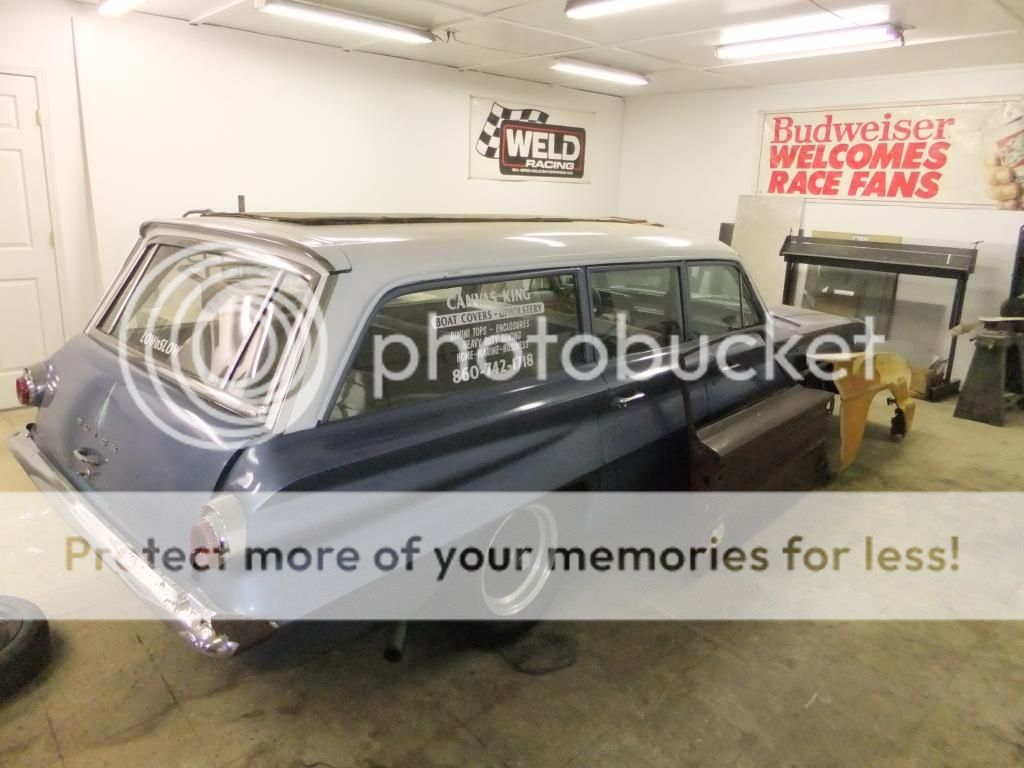

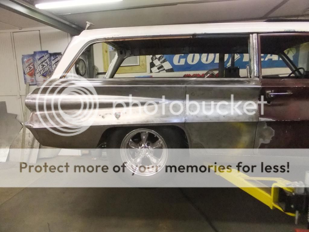

Pics of moving b pillar back, removing c pillar,grinding door skin off of back door, welding panel in off of back door and finishing the two door wagon look

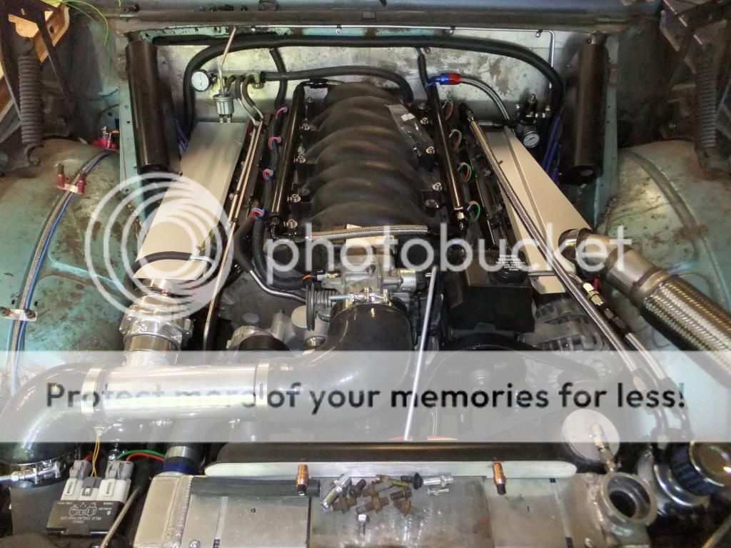

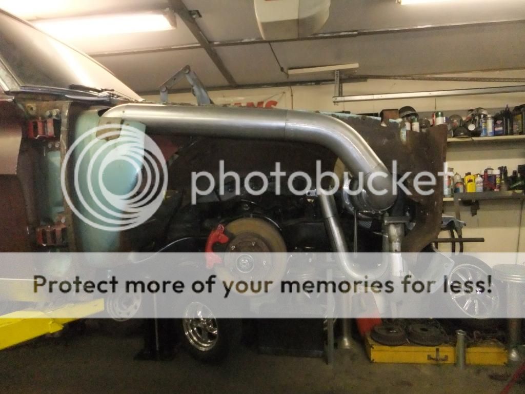

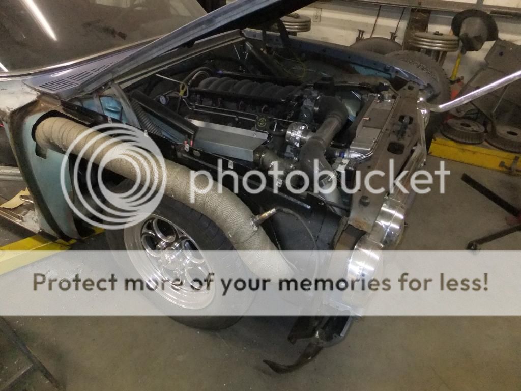

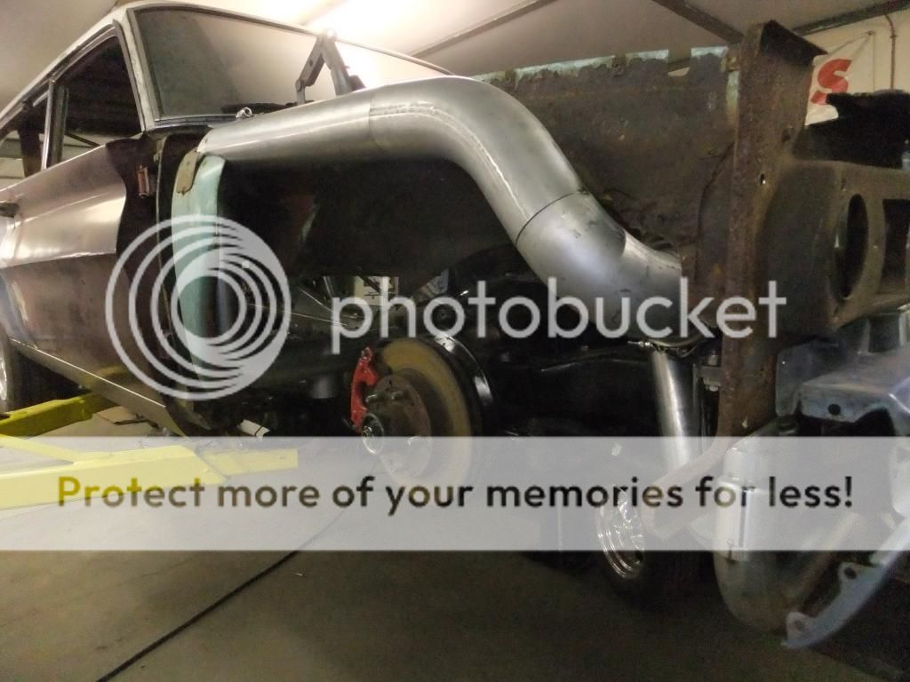

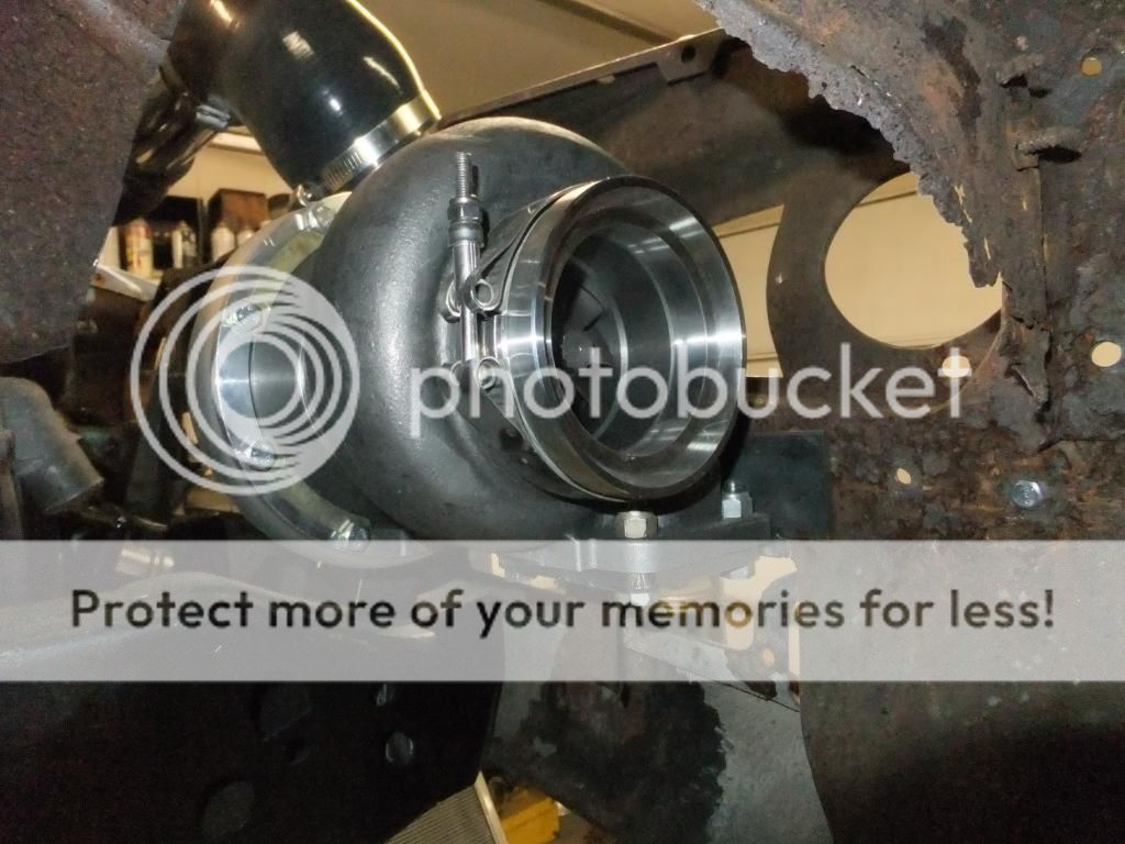

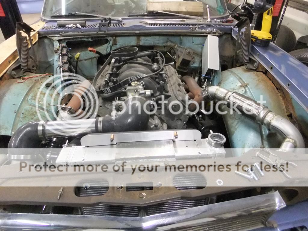

Thanks for the nice words Here is more of what has been going on with this conversion. This is some of the mockup for turbocharger with ls engine installed. All of this is coming back out so that I can repair all of the underhood rust with new metal

First off I am still new at posting pics so excuse my mistake again. Thanks for the nice words Here is more of what has been going on with this conversion. This is some of the mockup for turbocharger with ls engine installed. All of this is coming back out so that I can repair all of the underhood rust with new metal.

That's one bad MF'er your building. What trans and rear end set up you gonna use?
62 Buick Wagon Two Door Empty Re: 62 Buick Wagon Two Door
Post by rt338b Tue Feb 03, 2015 6:52 am
Thanks StageCat I am using a powerglide with brake and a 8.8 Explorer rearend

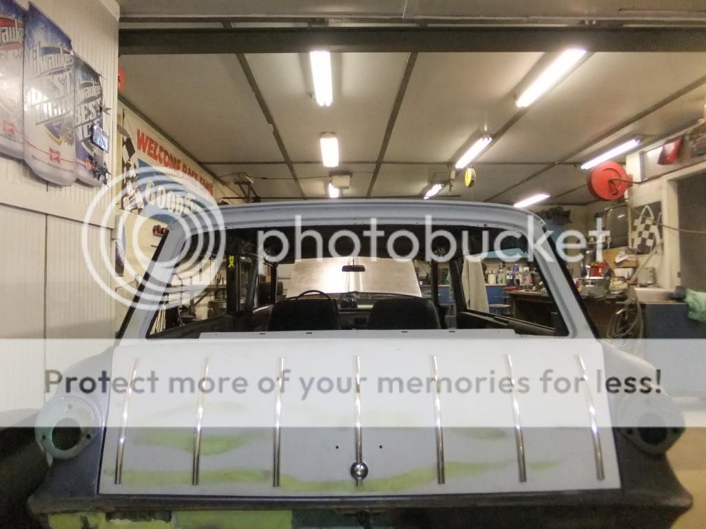

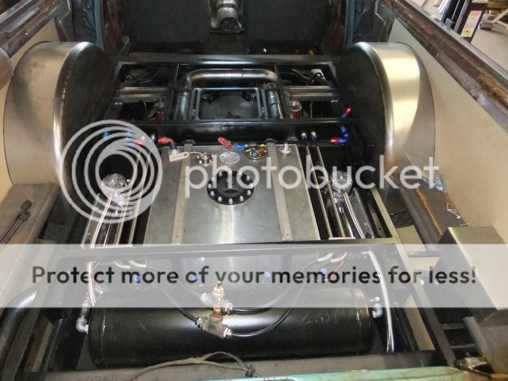

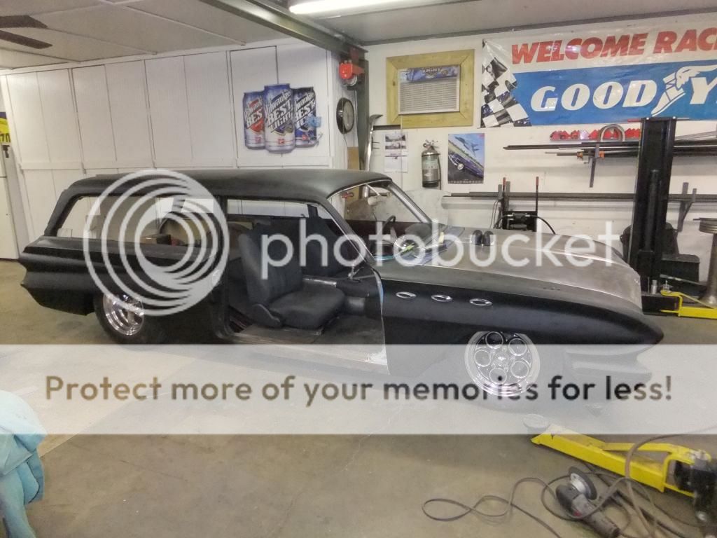

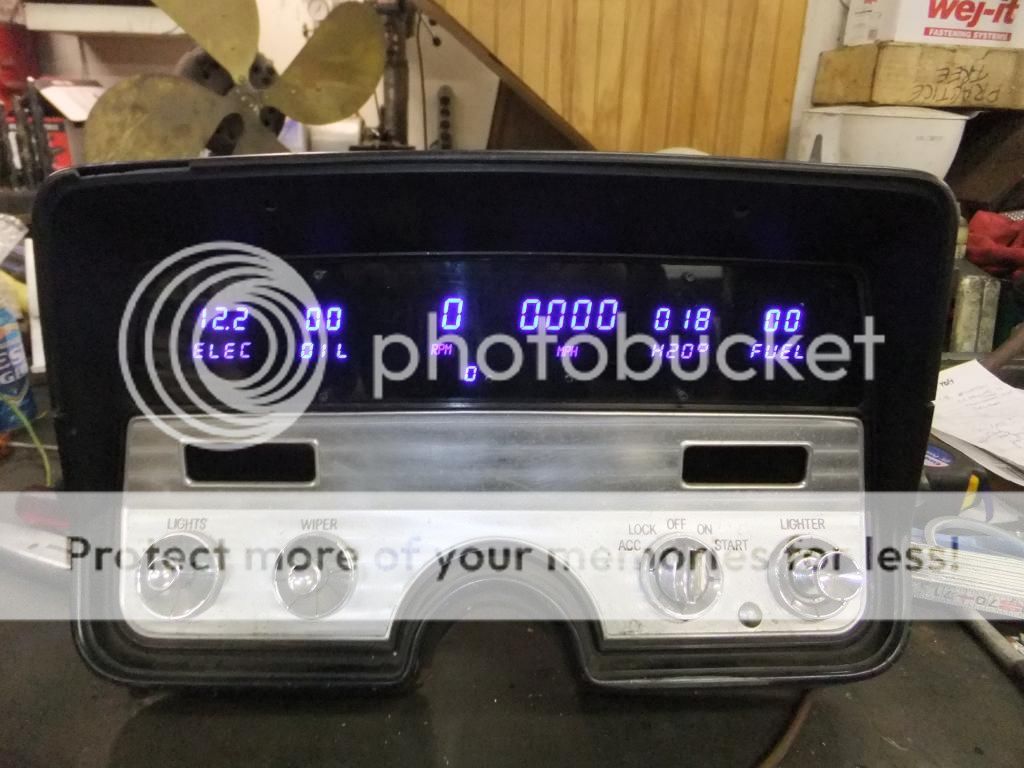

Thought I would update some older pics of things going on with the wagon. The instrument cluster had the rpm and mph backwards so I had to fix that. Cant imagine no rpm and 1000 mph lol Trunk area with mockup of airride and fuel cell also exhaust work over the rearend. floorboard with tunnel and Quarterstick shifter cover. 1961 Portholes fitted to 62 fenders and tailgate attached. Making nomad type bars for the tailgate out of 3/4 aluminum half round and forming to fit the curved gate and electric opener.
Post by Tim_D Tue Feb 17, 2015 2:25 pm
All I can say is WOW

Bill wrote:If people don't say it anymore they will once they see it. I can't wait to see the finished product here. Have you picked exterior color (s)?
Yes it will be two toned but until I get some of the color put on I don't want to say so that nobody else can try to use these colors. Strange but after all this time I would be pissed if someone else used them.You will be surprised and hopefully excited in its look.
