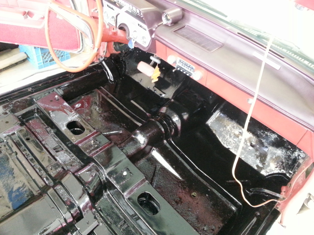

Post by cdnwillyg on Thu Jul 26, 2018 2:45 pm
I got the painting done around the rear seat and trunk then applied Por 15 to the floor and trunk, sure freshened it up. I will give it a day and then seam seal the joints before applying the "peel n seal"/ insulation prior to carpet.
1962 Buick Skylark Convertible 20180741
1962 Buick Skylark Convertible 20180740
1962 Buick Skylark Convertible 20180739

Post by cdnwillyg on Fri Aug 10, 2018 8:07 am
Not a great week in terms of the Skylark, first off my dash isn't ready yet hopefully today, and now I find out that the top tubing I had sent up is not right for my original cylinders.Shocked  In 62 they used a cylinder that has a fitting inlet size of 1/2-20 and I'm told that all new cylinders now have 7/16-24 size. To try and find an adapter to work is not going well for me but the "Convertible Top Guy's" are trying to find some or tubing that has the fitting size for my cylinders. I'm hoping they find adapters because if I change the tubing to 1/2-20 then if I ever replace the cylinders ...which will be new I will need to buy different sized tubing again. Sad Sad
1962 Buick Skylark Convertible 20180815
