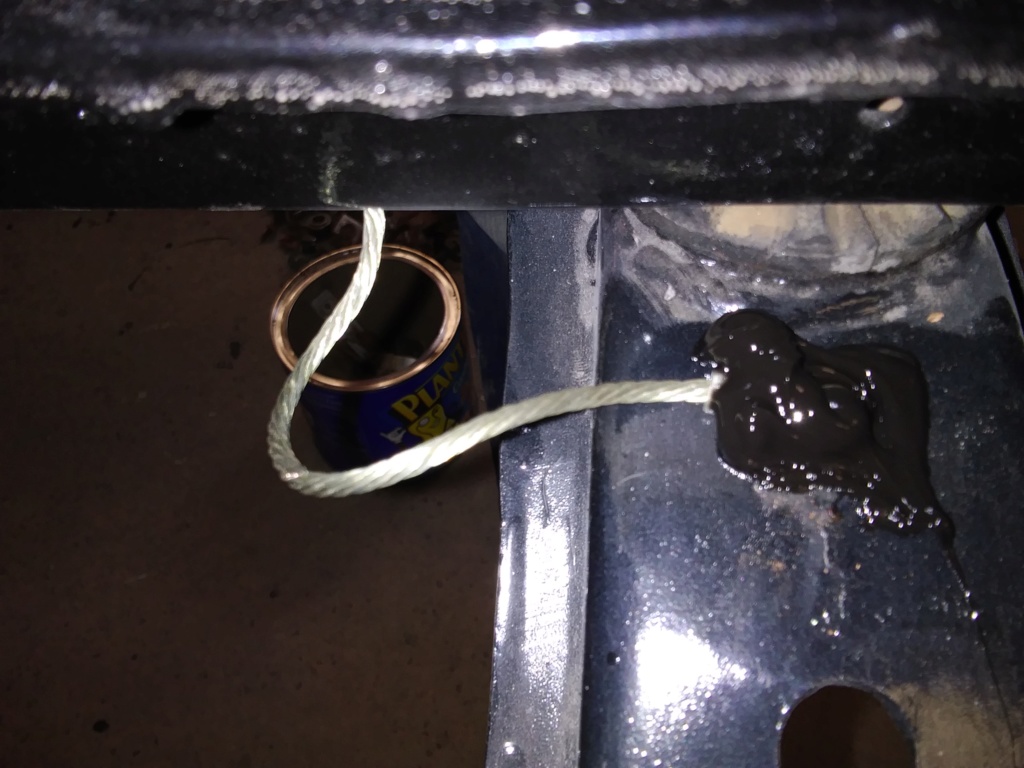

grounded the front suspension
what I'm starting with - Page 2 20181214

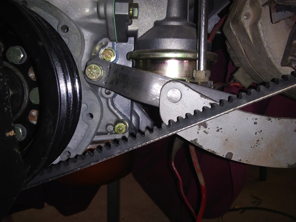

Post by custom880 on Wed May 01, 2019 3:47 pm
mounting the alternator on the drivers side
first I made a spacer out of an old bushing insert and welded washers the size of the bolt so it'll sit flush
what I'm starting with - Page 2 20190511
as you can see here it turned out ok
what I'm starting with - Page 2 20190510
I then made a simple bracket from the water pump to stabilize the unit.
what I'm starting with - Page 2 20190513
here's how it looks from the front
what I'm starting with - Page 2 20190512
to mount the adjustment bracket I went off of a bolt hole near the balancer.what I'm starting with - Page 2 20190514
this is the bracket that I made.
what I'm starting with - Page 2 20190515
still have to make one more bracket to add support to the mount point for the adjustment bracket. Used a piece of welding rod to get bends and size. It'll bolt to the lower bolt on the timing cover.
what I'm starting with - Page 2 20190516
I'll have to clock the alternator and I might build a heat shield to keep exhaust away from the rear of the alternator
what I'm starting with - Page 2 20190517
after I make the final bracket and weld them together I'll post it here.
