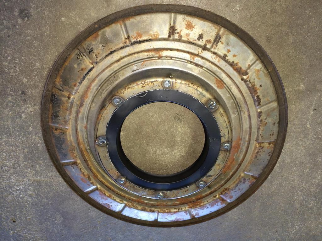

So this weekend I managed to get the 1405 E-brock carb I had purchased and rebuilt over a year ago installed. I wondering how, for anyone else whom has done the swap, has handled the air cleaner base being a different size ( 4 7/32" ) over the new carb's air horn ( 5 1/8" )? I'd like to retain the stock air cleaner -- I found an adapter that went the opposite way. Did I miss one?
Please tell me there is an easier solution out there beyond cutting the old air cleaner base up and welding in a new section....

I ended up cutting out the center of the stock air cleaner base, and sacrificing a "donor" base from a cheap stamped steel 14" open element air cleaner. A few spot welds around the perimeter, and voila!

I bought a 5 1/8" x 2" high aluminum riser from Summit-Keyser 100 68827-2.0 for $17.50 for my Cutlass. It has a rubber O ring on one edge. I put that up and the air cleaner sits right down on it and seals nicely on the radius. Of course the hole in the air cleaner is not 5 1/8" but when looking down at the carb with the orig air cleaner base installed it looks like good flow. Since the Edelbrock is shorter that the orig carb the orig air cleaner clears my Cutlass hood.
Another thing that was suggested to me is to simply use the 5 1/8" base of a new air cleaner and let the filter alone support the orig top. That allows for air coming in the bottom and getting filtered since the new air cleaners you can get are smaller than the origs.

Here's looking down the throat of the stock air cleaner bottom with the alum riser. Then the orig stock element marked same as air cleaner trumpet that is tight to the baffle plate and the smaller element that is back from the baffle plate. Then the newer element that fits on the smaller ring on the cleaner bottom and the old AC A 124 C element that was in the car that goes out to the outer ring. Smaller element is 10.75" and older larger AC element is 11.5"

Additionally, I appreciate the suggestion of using the 14" edelbrock assembly bottom plate with the OEM top assembly -- it appears to be a sufficient solution to my carb conversion!! No need for anything else now!
