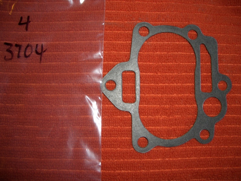

Update-Found that “Best Gaskets” stocks an eng gasket set for these engs and it has an original style oil pump gasket #3704 WITH the slot relieved-just like the pic in the service manual. Got one coming.
Melling says their gasket has been made the way it is currently supplied (no relief for the long slot) for 36 years, beyond that no history. Wondering if there was a change in design at that time for Rover or the Buick V6 and nobody even cared about the lowly 61-63 engs?

Here's the Best Gaskets oil pump gasket. See them on Ebay for $9-10 dollars. These from Egge Machine at $1.48 each.

Thanks for the information. I think your instincts are correct. If I was making one gasket to service a couple decades of very similar designs (Melling) and could save a buck on a die that relieves the gasket capturing the pump cover, I probably would also. 36 years ago was 1982. By then, the 215 was out of production for 19 years, but the 231 3.8L V6 was a high volume engine. Since the 215 V8 was the grandfather of all of the succeeding Buick V8s, (same for the V6) the pump architecture was used and iterated until the 3800 serries engines went to a crescent pump. By then all the V8s were gone. Rover did the same at some time as well.
Seems to me a simple gasket punch would do the trick to relieve the suction behind the gasket also. ,...my three cents.
