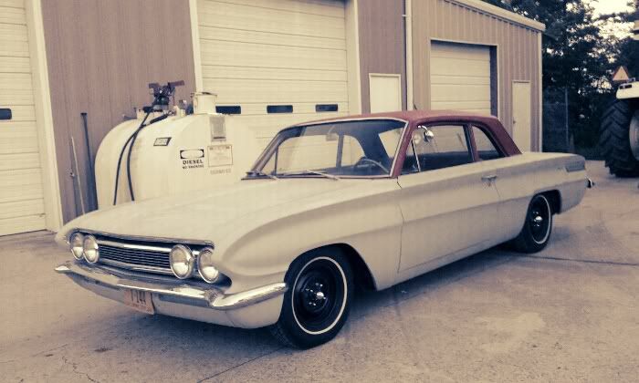

That being said............ here's my project of the last 6 years

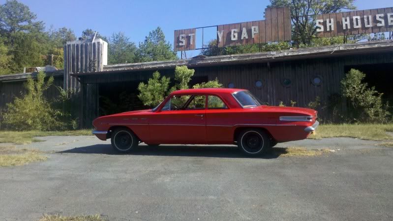

What I started with, don't let the pics fool you. It was a mess under that cheap red paint!

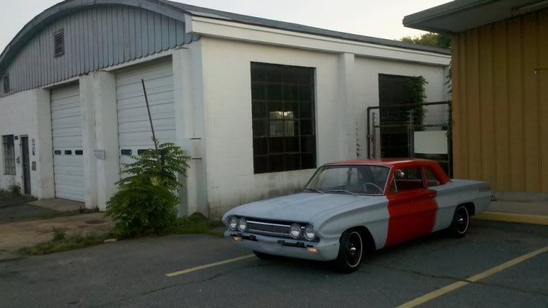

First things first, needed to sit lower!

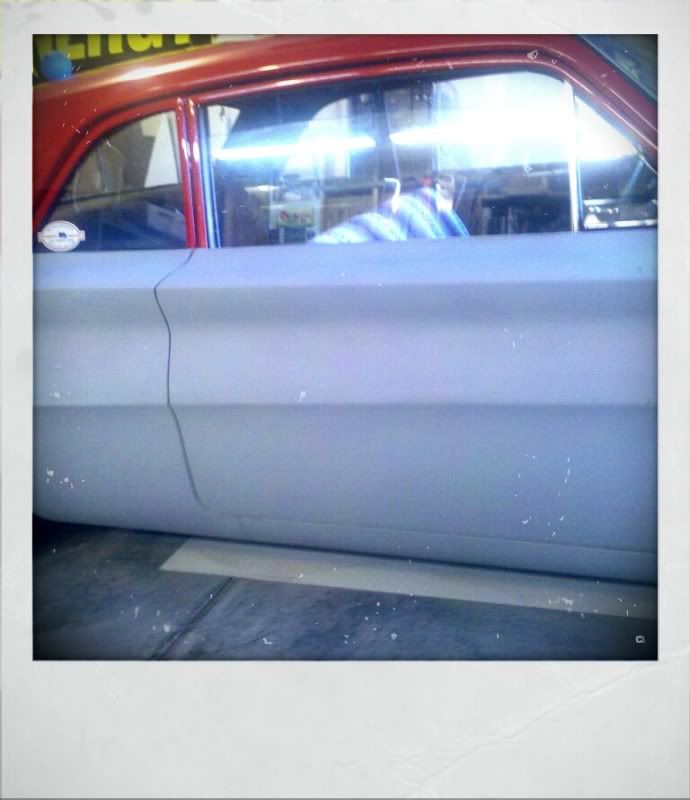

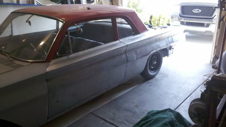

Drove it like that for a summer and then the "just a bit of body work and a quick paint job" began.... It wouldn't be painted for 5 years!!
Things were looking good as I worked from front to back.... and then.............

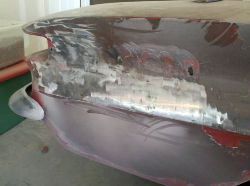

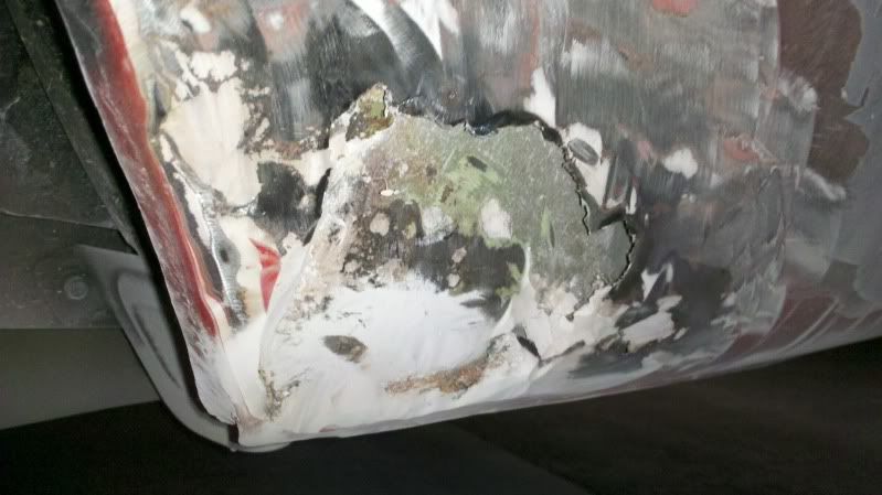

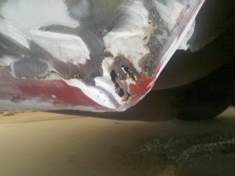

Bondo as thick as the eye could see it! And some quality metal work and rust repair. (sarcasm)

the hits keep coming! This entire hole was packed full of steel wool and bondo

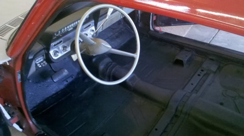

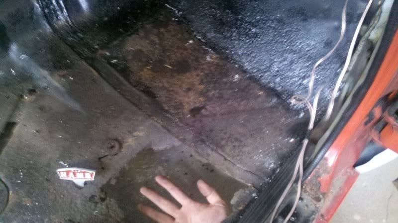

The floors were next.... YEESH!!!!
I made all the patch panels and welded them in (i had never done either before). It came out OK, If I redid it today I know I could do better, but it is solid and with a coat of POR15, seam sealer and bedliner I don't think I have to worry about rust for a long time.

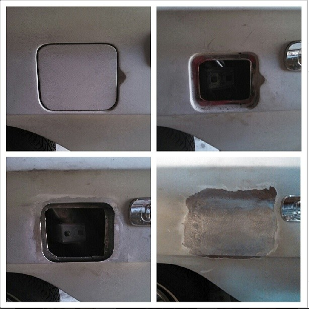

Then I started getting brave.. So long door handles!

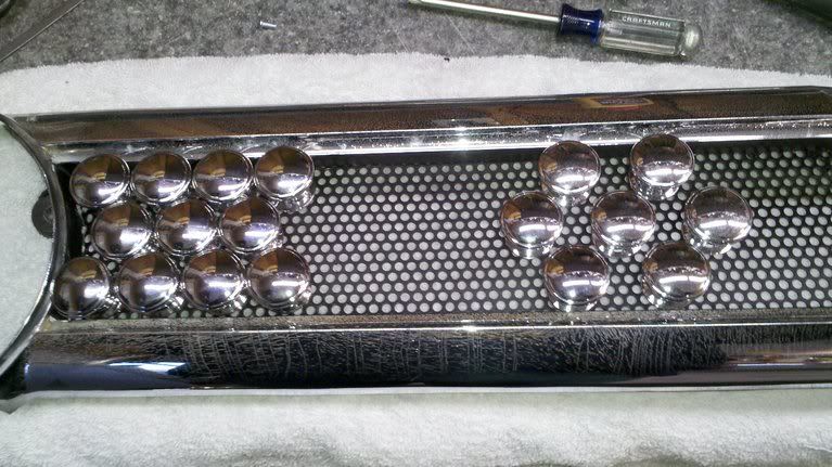

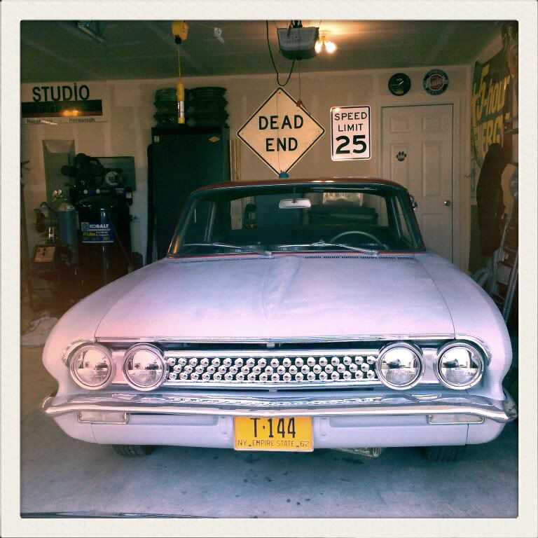

I decided to take a risk and hack up my stock grill for something a little more "custom"
I saw the grill on this car by Alex Gambino and loved it. So I decided to try my hand at something similar.
So with a cut off wheel, some expanded metal, sheet aluminum and a mess of chrome cabinet nobs from the local habitat re-store I got to work.
The finsihed product! To this day the grille gets more compliments than anything on the car.

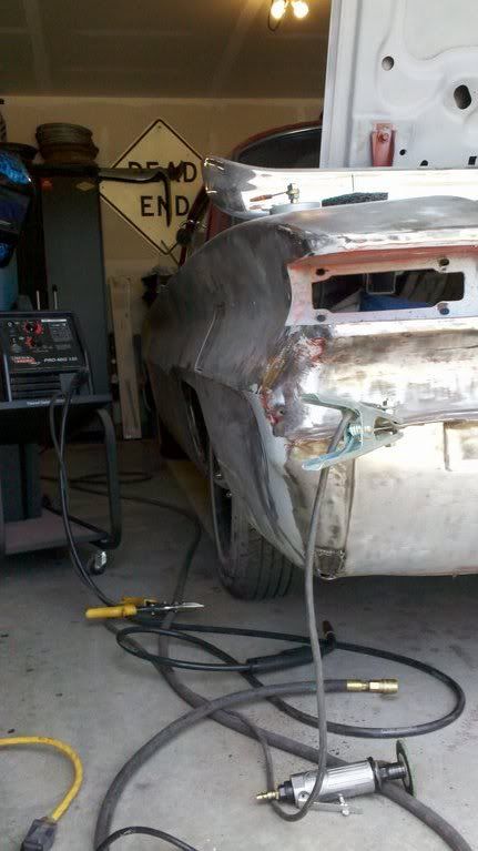

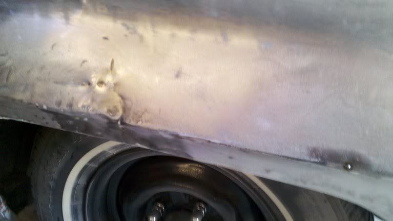

Back to work on those quarters. They were rough but I couldn't afford to replace them. I think desert valley wanted as much for a set of quartes as I paid for the whole car.
After welding in some patches and filling a mess of trim holes I got back on the body work

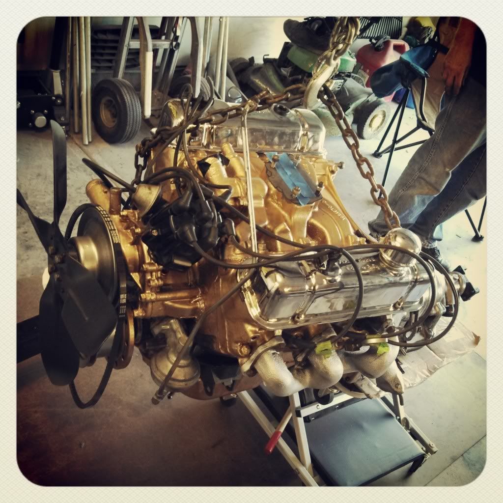

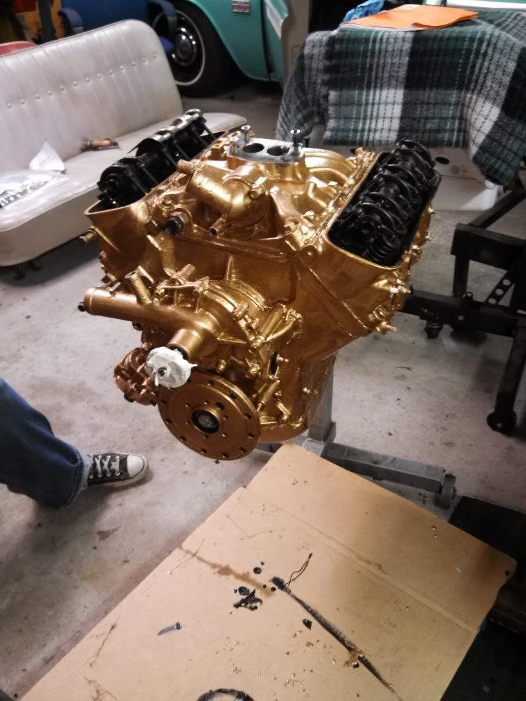

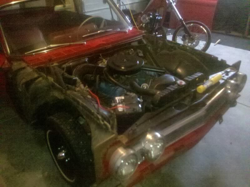

The car had developed a ton of leaks and was smoking like it was on fire. Time to pull the little 198 out and try and band-aid it. I sourced every seal I could find and with help from my mechanically inclined friends we re-sealed everything. Also took the time to paint the engine and get the valve covers chromed. Turned out pretty good.
things got weird.....
replaced the timing chain and had the water pump re-built too
POR15 Oldsmobile gold

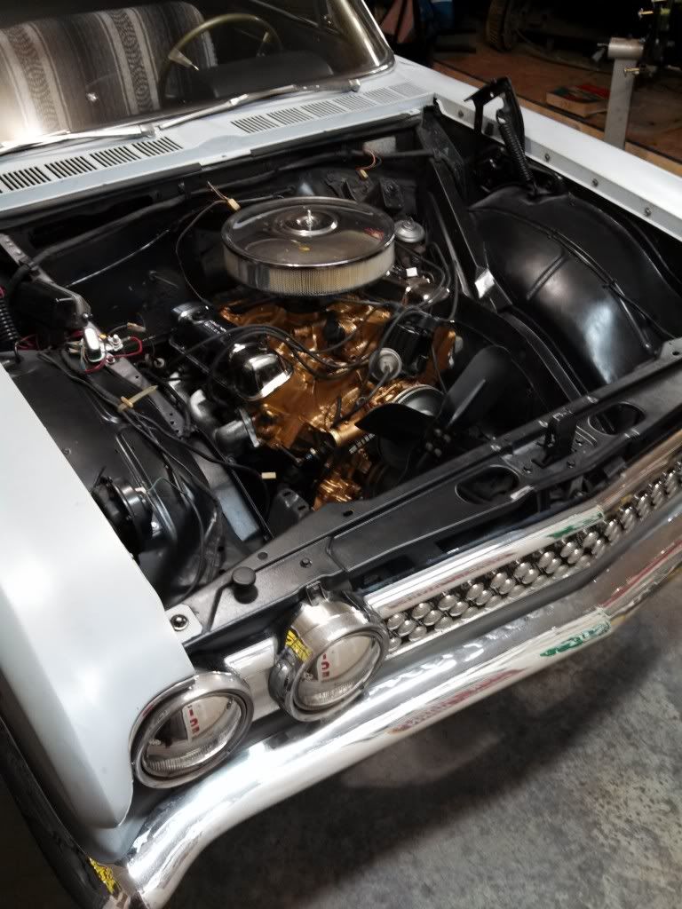

going back in

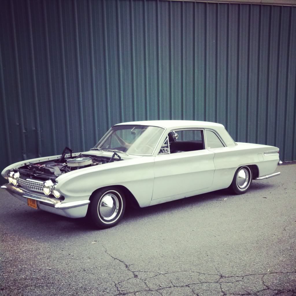

back on the road!
going back in
back on the road!

See ya gas door!
new filler in the trunk
filled in the holes where the "portholes" were

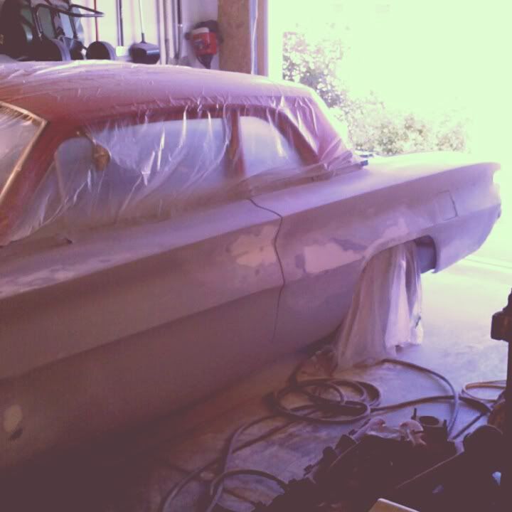

After more driving and fun I decided it was time. This thing was gonna get painted and get a decent interior.

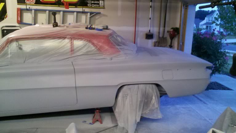

I took it to my dads house where he made a temporary paint booth.
During this time my daughter was born so the car naturally took a back seat.
back on it! Dad spraying some sealer

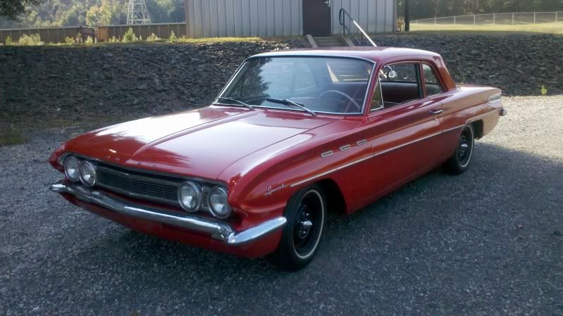

All done............ for now

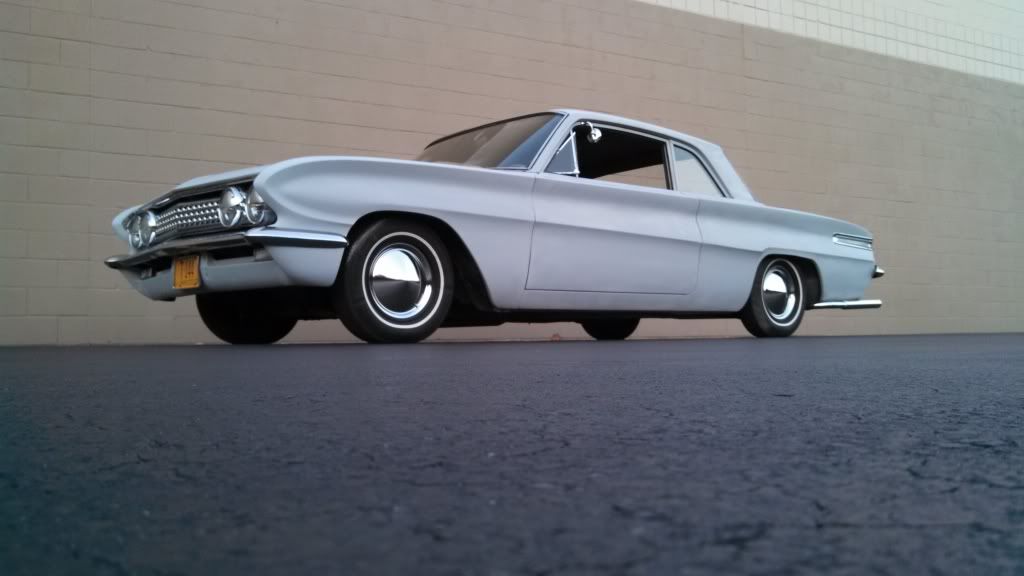

Quick question if you don't mind me askin' -- how'd you go about lowering it? New springs? If so, do you have the source and part #'s or any other info? I'm wanting to replace my springs and shocks here SOON and just trying to figure out how to go about getting the ride height I'm after and not suffer comfort in the process w/o going air ride.

I cut the coils front and back. I did this about 5 years ago but think 2 up front and 2 1/2 or 3 in the back. It sat very low when it had the 13" wheels. Since switching to the 15's it sits at a nice height:
